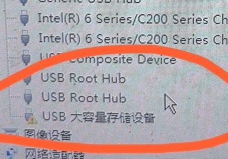

Hello, could you please tell me how to make the hard drive enclosure be recognized by the computer again? My hard drive enclosure is showing as a "Mass Storage Device".

if you explain the enclosure you have and show screenshots of your problem
and explain as much as you can i can try and help
did you backup your firmware before hand as the instructions above give?
do not just go blindly flashing that back onto it or your in for a world of hurt
it has no nvram i have to add the nvram before its flashable

Hello, my hard drive enclosure and firmware are exactly the same as yours. The current status is as shown in the picture.
I can try adding the NVRAM, but the firmware update tool no longer recognizes the device, and on the computer, it only shows up as a mass storage device, with a message saying "This device cannot start." Do I need to use a programmer for this?
