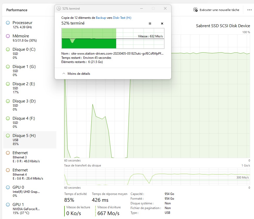

What drive do you have in there? I would love to get that kind of consistent performance out of my drive.
2 years 11 months ago
here it is the disc
Station-Drivers - Test ASUS TUF Gaming A1
