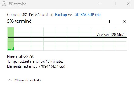

Hi, I changed notebook, and the speed is ok. But my doubt remains: I first updated the chip with version 0209 and then I updated it with 20.05. Any problems? Do I need to downgrade? Are the two zip files I used to update the chip correct?

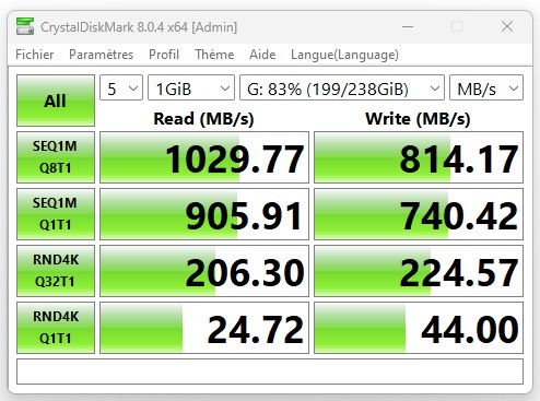

I did a test with my USB 3.1 nvme box on an Intel USB 3.2 port here are the results
some chipsets do not really like copying small files because too much calculation and the speed drops
