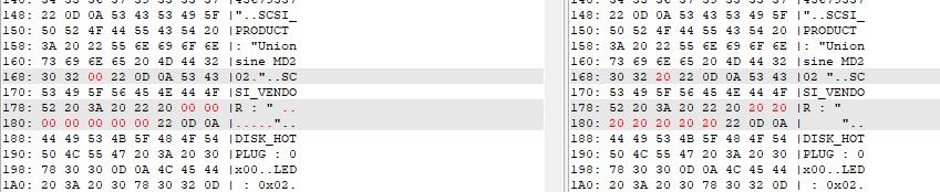

I have a Unionsine MD202, dumped the config, flashed the latest fw from this topic and it works, though it is strange that I could not write 00 - as there is 20 again dumping the flashed unit...
