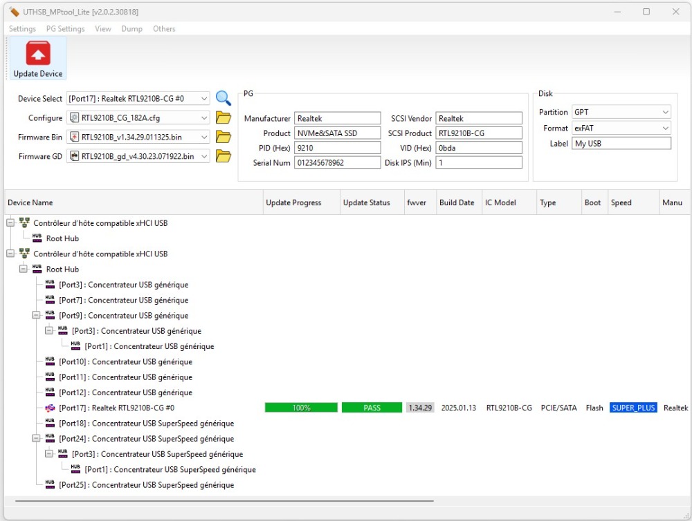

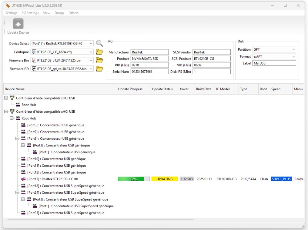

Hello everyone. I have a problem.
I have Fanxiang MD-86 with RTL9210B. I just updated firmware to 1.34.29.011325, somehow the display can't read S.M.A.R.T from my SSD (XPG Gammix S70 Blade 1TB) after updating. Perhaps someone here can help me to find out the problem.
I'm using UTHSB_MPtool_Lite.exe to update it, and i checked Firmware Update and PG, do i did something wrong with that? I attached photos for some info.
Thanks before.
Thanks before.
